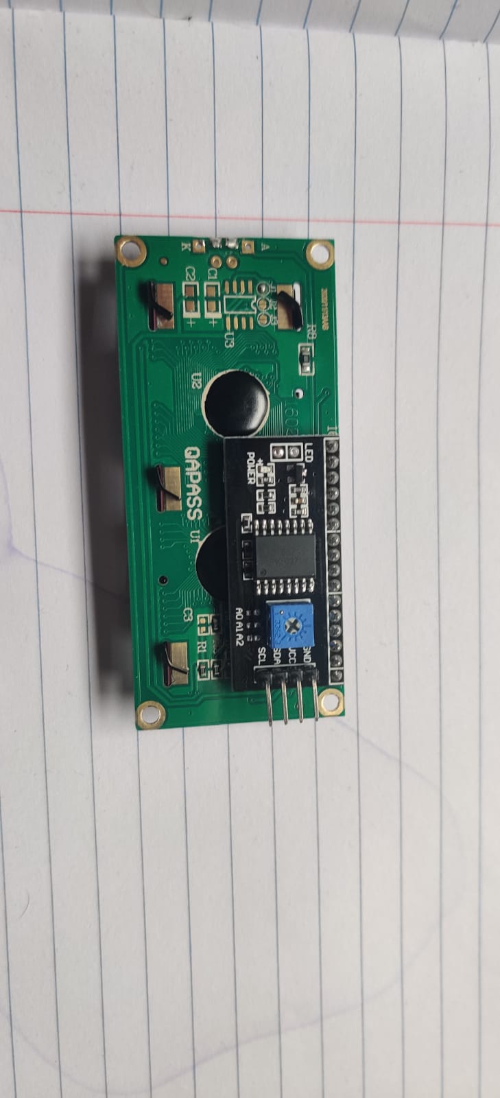

this is the lcd with controller i use
lcd i use
WhatsApp Image 2021-03-10 at 09.40.12.jpeg (87.57 KiB) Viewed 18479 times

Default address on similar I2C adapter (using a PCF8574) is 0x27 (39 decimal) which is compliant with the address the scanner returned.

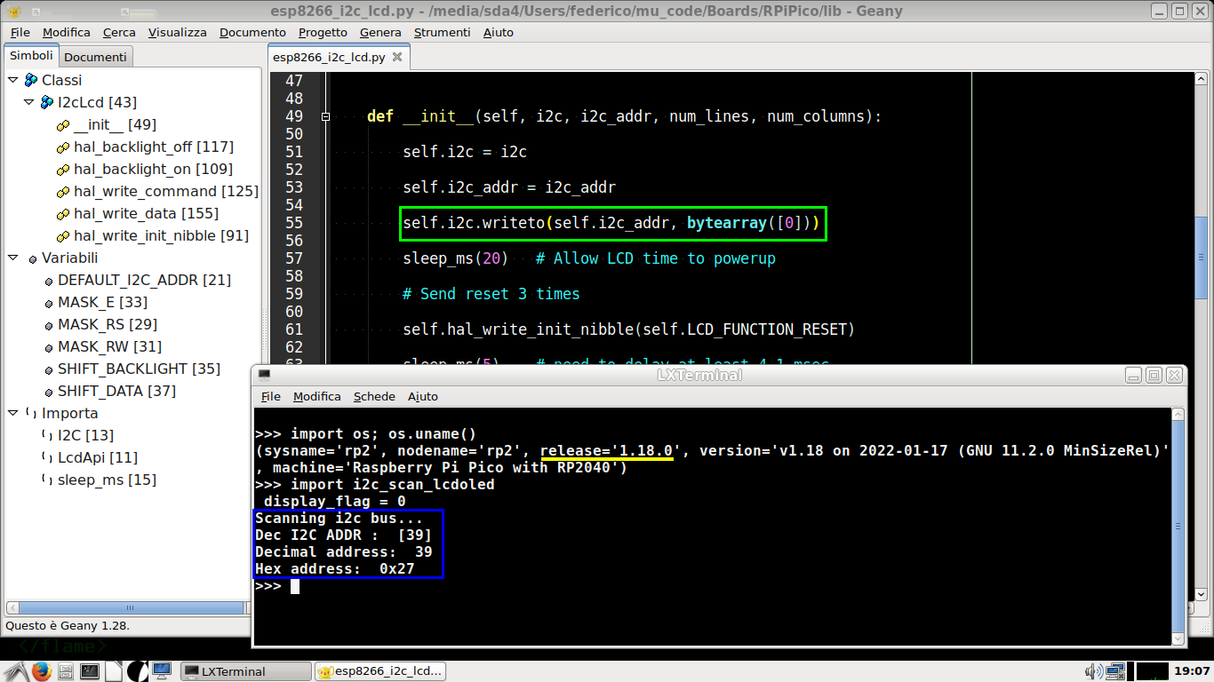

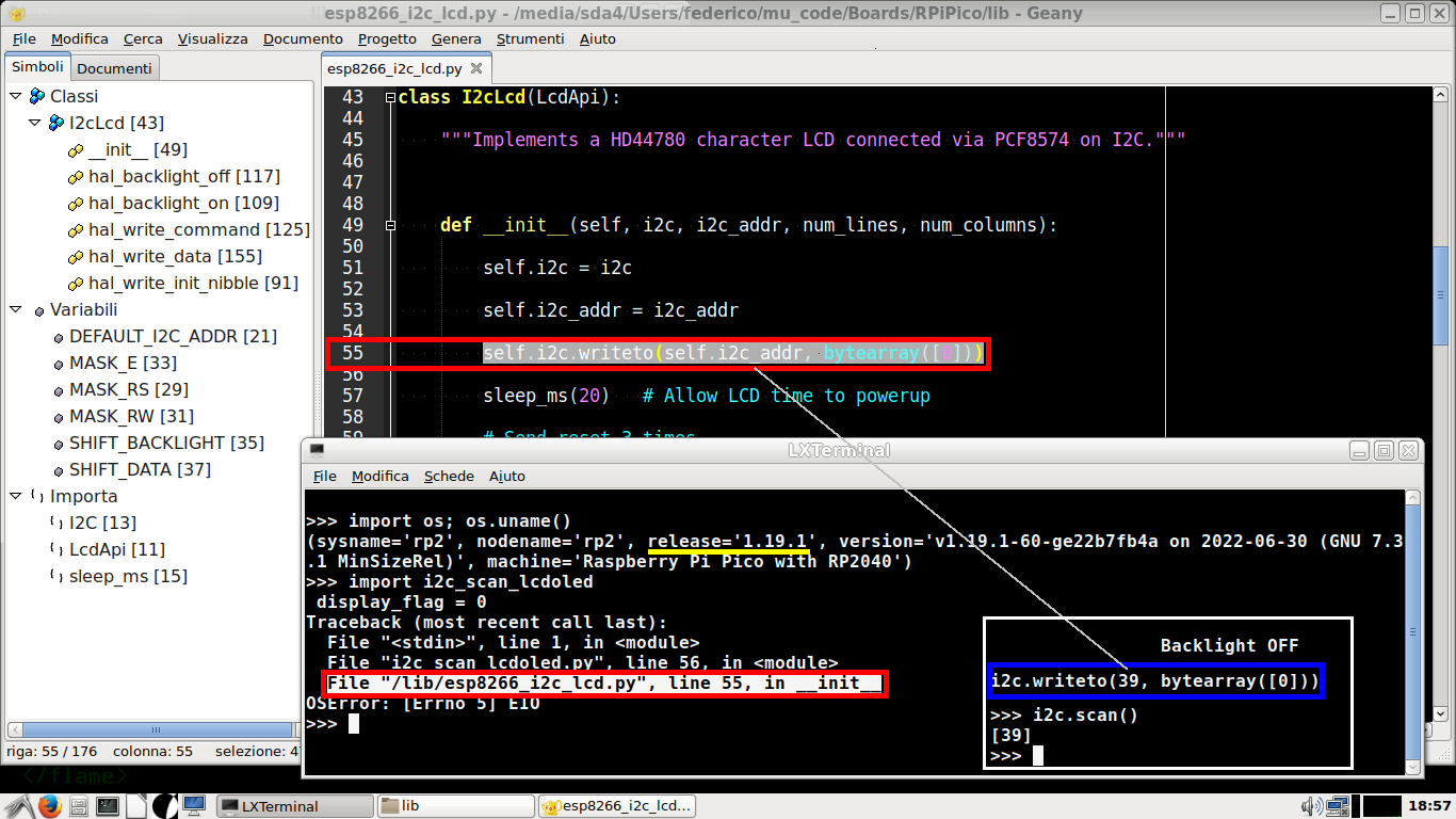

# Raspberry Pi Pico
# to test the with micropython 1.19
# OSError: [Errno 5]- EIO
# esp8266_i2c_lcd.py, line 55  in __init__
# the following is the code in line 55:
# self.i2c.writeto(self.i2c_addr, bytearray([0]))
# that set to OFF the LCD backlight
# !! with releases ver. <= 1.18 no problems
from machine import I2C, Pin
scl_pin=11
sda_pin=10
i2c_ID=1
i2c = I2C(i2c_ID, sda=Pin(sda_pin), scl=Pin(scl_pin))
i2c.scan()
if i2c.scan().count(39)  == 0:
    print("No i2c display found !")
    from esp8266_i2c_lcd import I2cLcd, DEFAULT_I2C_ADDR
    lcd = I2cLcd(i2c, DEFAULT_I2C_ADDR, 4, 20)

Post by federico » Sun Jul 03, 2022 6:55 am
A retest with another RPi Pico with micropython release 1.19 installed was successful - which rules out problems with the new micropython release
