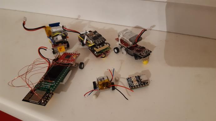

I have built more bots, top from left: Tiny2040bot, Picobot, Toycarbot
bottom from left: Pico4MLcbot, Tinier2040bot (not completed, will be 19.7×14.8×18.6mm w×l×h):
Tiny2040bot and Picobot have ESP8266 model ESP-01 with WifiToSerial.ino example for wireless RP2040 MCU MicroPython REPL access. Pico4MLcbot has ESP8285 model ESP-1 (similar to ESP-01, here without headers) for same purpose.
It is clumsy to connect the RP2040 MCUs with micro USB for uploading new MicroPython files. And with wireless REPL access, wireless put/get of RP2040 MCU files should be possible.
I learned that Python telnetlib allows to access the Picos via the ESP8266/ESP8285. Tried to see how webrepl does file upload, but that has a server component. So I looked at ampy, that I know for file transfer over USB or serial. I was really surprised to see telnetlib used in ampy. I learned that ampy decides to use telnet for a "port" that starts and ends with a digit, and has exactly 3 dots. Fine, but that did not work. Reason was that ampy passes username and password into the telnet session for login. There is no login in WifiToSerial.ino nor on Pico MicroPython. So I did fork ampy, removed the username and password code, updated README.md with fork mission statement and install command:
https://github.com/Hermann-SW/ampy#fork ... eplacement
After ampy now works for ESP8266/ESP8285 WifiToSerial.ino requirements, there is no need to use USB port anymore. Because of that I was able to superglue red DRV8833 motor controller board on Pico4MLcbot back as it was planned initially, although now the short cables from the motors to motor controller now make it impossible to connect USB-C cable to Pico4ML MCU.
