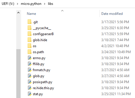

You couldn't reproduce because I had a screwed up environment... well specifically; a weird environment which micropython should have given me a error or something.
I had two copies of stat in my 'lib' folder - probably due to specific some upip weirdness.
Basically I had 'stat.py' in the stat directory of libs and 'stat.py' in the root of libs.
Once I removed the stat directory; it started working properly.
For some reason the same thing happen with glob... it's unclear why.
