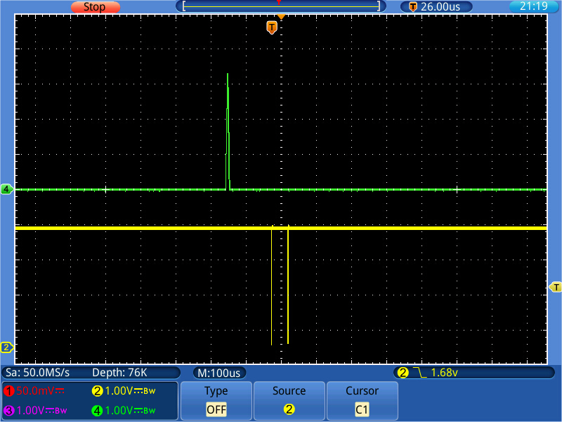

It could be a mix of both. The 4N35 is not really fast, especially when switching off. That's common to optocouplers. The data sheet talks of 10 µs. You could speed that up by a resistor between Base and Emittter (pins 4 and 6), which in turn also reduces sensitivity. And the way the optocoupler is driven may also cause a slow ramp. Attached is a picture which shows the effect for a triangle pulse of 10µs width. When I had that on a ESP8266, I could not add an additional gate, so I cleared the IRQ flag in the ISR when handling the first IRQ. That worked out. The code for that is pretty simple:
# Clear Interrupt status
@micropython.viper
def clear_isr(mask: int):
    ptr32(0x60000324)[0] = mask
And it is called with:
clear_isr(0x20)  # clear interrupt mask of Pin(5)
You may have to adapt that value 0x20 for the Pin number you are using.
