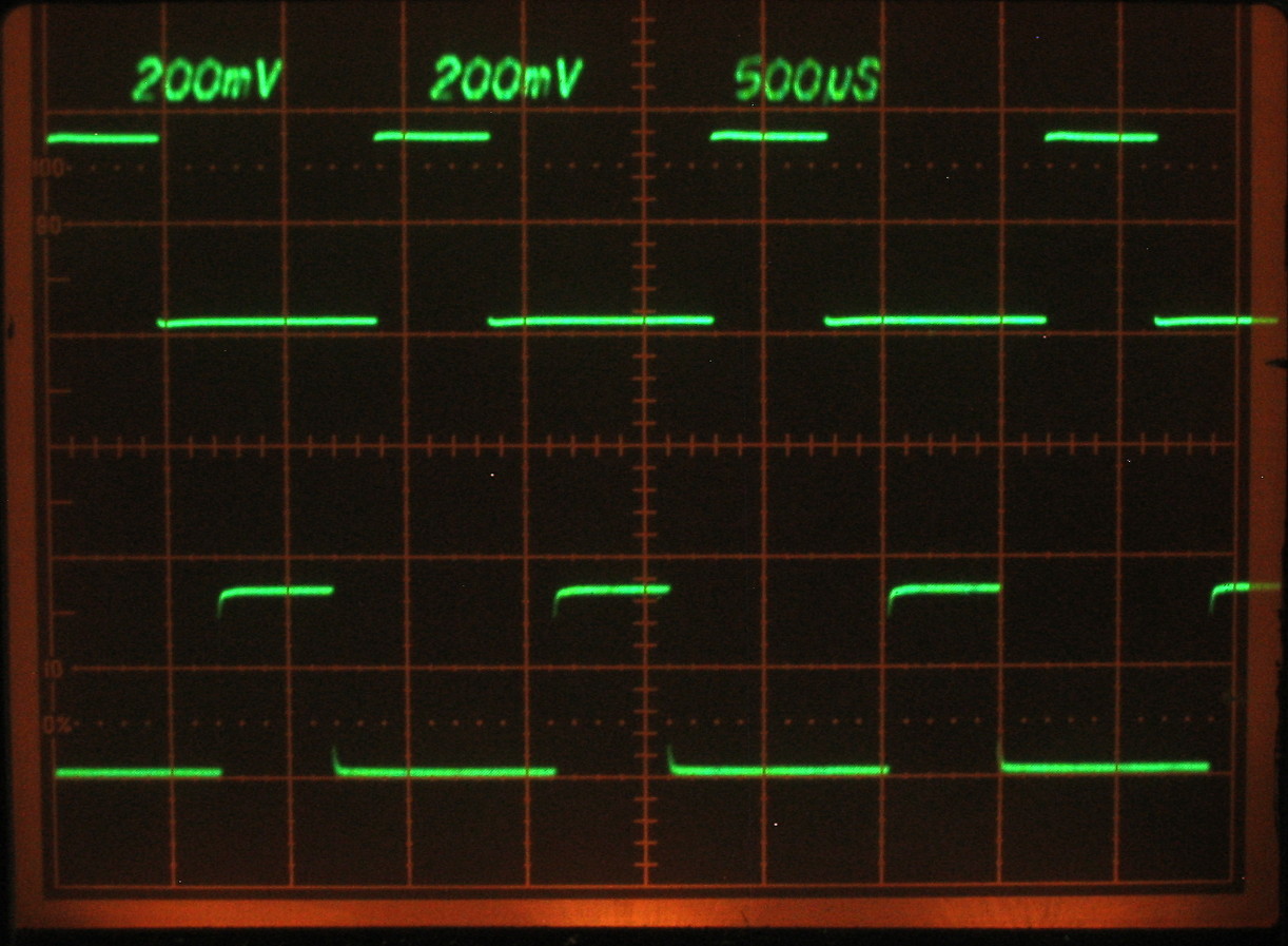

Thanks! Got some good output finally! I was wanting to use the repl to change xfmr_pulse_w = 1900
to something else. I also have a timeout when the count goes way up, (I'm going to use that for bursts), so I want to reset from the repl.
<ctl> d resets OK.
this scope photo shows how the pulses on two pins are non overlapping, and by changing the pulse_width variable on each channel when there is no edge coming soon makes for a jitter free set of pulses on two wires. The program has a quota for pulses, after which different tactics can be used. I will make it stop pulsing both after a certain number. That needs some debugging.
This is the code that generates the above pulses. The speed is maxed out at a cycle time of 400 microseconds, so to get faster non-jittery pulses, I think using a gated mode might skip some of the interrupts that can't be handled fast enough...
