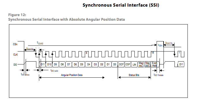

I have a digital sensor that outputs data to a Synchronous Serial Interface (SSI) according to a protocol that's shown in the figure below:
Screen Shot 2017-04-20 at 18.53.46.png (44.31 KiB) Viewed 11908 times
As you can see from this datasheet https://ams.com/ger/content/download/43 ... _EN_v2.pdf the reading of the value is init by an high impulse on a sensor pin and after a period of time (which is written in the datasheet) the sensor starts to output values on the serial line.
Any subsequent reading of the value are init in the same way.
The problem is that this particular protocol is not coded in any MicroPython class, because it's not SPI nor UART nor I2C or any other protocol which is included with MicroPython distribution.

This looks vaguely like I2C. You might check the details, it might be actual I2C (also called IIC or TWI), but they avoid calling it by name because there were trademark and patent issues with it.
Otherwise, you should be able to read that with the SPI peripheral.

You can create the signals CSn, CLK in Python and read also the data back, since the device has no restriction on slow reading. The clock raze that can be achieved depends on the code generator used. Using viper code, about 1 MHz could be possible.
