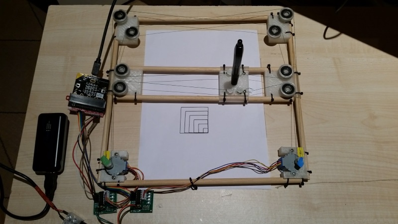

Took me a while as a side project but I got there in the end and created a micro:bit based pen plotter using core-xy kinematics and micropython.
I'll need to update my GitHub library to provide the CoreXY class but the code to create this image was:
    s1 = Stepper(FULL_STEP, microbit.pin3, microbit.pin4, microbit.pin5, microbit.pin6, delay=1)
    s2 = Stepper(FULL_STEP, microbit.pin13, microbit.pin14, microbit.pin15, microbit.pin16, delay=1)
    c = CoreXY(s2, s1)
    i = 6
    while i > 0:
        c.left(150 * i)
        c.down(150 * i)
        c.right(150 * i)
        c.up(150 * i)
        i = i - 1
As you can see below, the construction is somewhat ghetto and the movement speed is quite slow (a few mm a second) but given that it's held together with zip ties, using wooden dowels as rails and fishing line instead of belts I'm reasonably pleased with the results and it was cheap to make. OK, I used a 3d printer for some parts but they are very basic and could be replaced with wooden blocks.
Thanks again for the help/encouragement from mattyt and pythoncoder!

Post by pythoncoder » Mon Sep 18, 2017 8:12 am
Glad you got it working :) An ingenious low-cost build.
