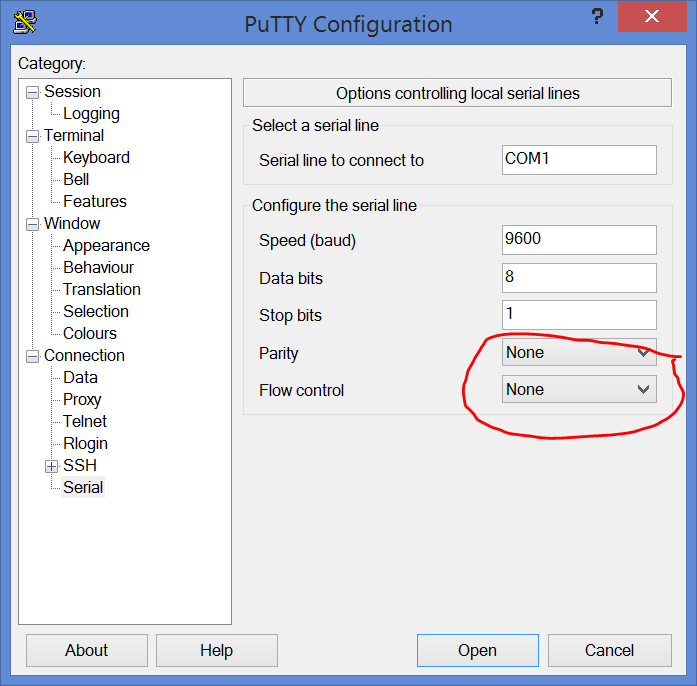

Post by Roberthh » Wed Jun 13, 2018 8:55 pm
Did you switch off flow control in putty?

Post by mattyt » Tue Jul 17, 2018 12:53 am
Sounds very much like flow control, as @Roberthh mentioned.
To clarify, Flow Control, in the Connection/Serial category, needs to be set to None:

I've been fighting my microPython connection with PUTTY for two weeks. It would print microPython header and initial prompt ">>" and then not respond to my input. I know that it was working correctly, because it was burning correct firmware (getting proper outputs).
I finally saw this post regarding the --necessary-- PUTTY setting of flow control "None".
Changed from PUTTY serial configuration from "Xon/Xoff" to "None" for the microPython serial port and problem solved.
