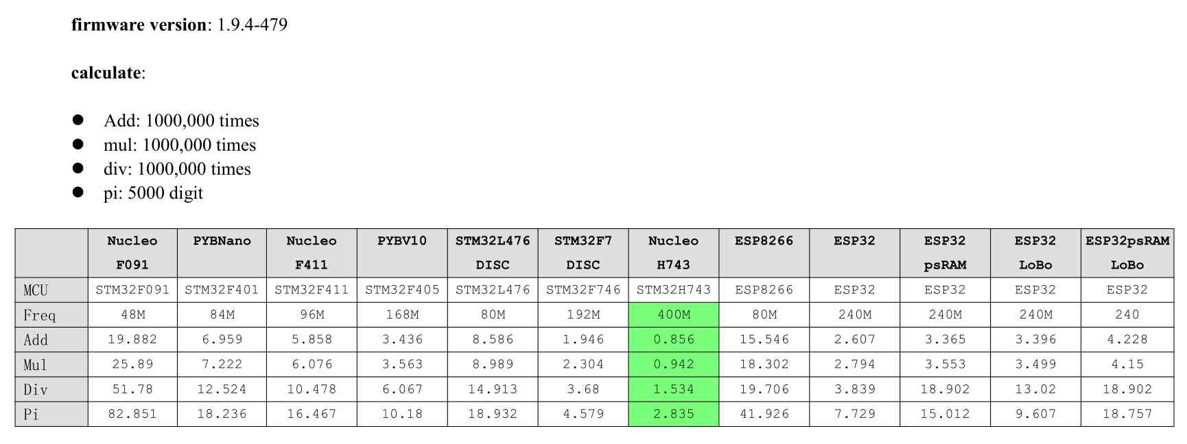

I have made a compare of calculation benchmark of micropython in different hardware, I hope it will be helpful to you.
Because forum does not support table, so I put result in a picture.
runtest.zip
(631 Bytes) Downloaded 677 times
I have made more test, and put it in github:
https://github.com/shaoziyang/micropython_benchmarks

You should place a link to a google spreadsheet (just make sure to make it readonly so only you can modify it).
Also if you’re really interested in providing a complete picture of performance, you should provide the info for each of the emitters: normal, native, viper

Interesting and informative information. It will be interesting to see how the forthcoming Pyboard D-series compares.

Very interesting is the comparison of the ESP32 modules with and without PSRAM. That matches the subjective impression, that devices w/o PSRAM are way more responsive.

without warranty: 216M, 1.547, 1.721, 2.839, 4.116 :-)

Just a few other numbers:
Teensy 3.6. 180Mhz, 2.65s, 2.78s, 4,14s, 12.2s
Pycom LoPy4: 160MHz, 5.75s, 6.07s, 10.1s, 17.6s
Pcom LoPy: 160MHz, 5.7s, 5.9s, 8.3s, ---
LoBo ESp32 SPRAM: 240MHz, 4.04s, 4.15s, 18.9s, 19.3s
The Pi test shows a substantial variation. The low values for the Div test of the ESP32LoBo & ESP32MP with PSRAM are somewhat strange, compared to e.g. the LoPy4 with PSRAM too (which runs at 160MHz).

Some more numbers from Pycom LoPy4
[code]
Pycom MicroPython 1.19.0.b2 [v1.9.4-7ec4c0a] on 2018-06-15; LoPy4 with ESP32
>>> import runtest
Speed test
System freq: 160.0 MHz
Add test: -5.654 s
Add test: -5.656 s
Mul test: -5.953 s
Mul test: -5.954 s
Div test: -10.008 s
Div test: -10.024 s
Pi test: -27.949 s
Pi test: -28.163 s
[/code]

I modified the test a little bit, packing into the loop 10 times the same operation (add, mul, div) and reducing the loop count by a factor of 10. Some sample numbers:
ESP32 MP : 204 MHz, 1.009 s, 1.201 s, 2.289 s, 8.514 s
ESP32 MP with PSRAM: 240.0 MHz, 1.308 s, 1.498 s, 6.74 s, 15.189 s
LoPy4: 160 MHz, 1.984 s, 2.286 s, 6.304 s, 17.756 s
WiPy2: 160MHz, 1.935 s, 2.231 s, 4.597 s, Fail
PyBoard 1.1: 168 MHz, 1.157 s, 1.312 s, 2.881 s, 10.344 s
Interestingly, on LoPy4 the Pi test in once instance took 47 seconds, but the 17 seconds figure is more consistent over test iterations and device.
