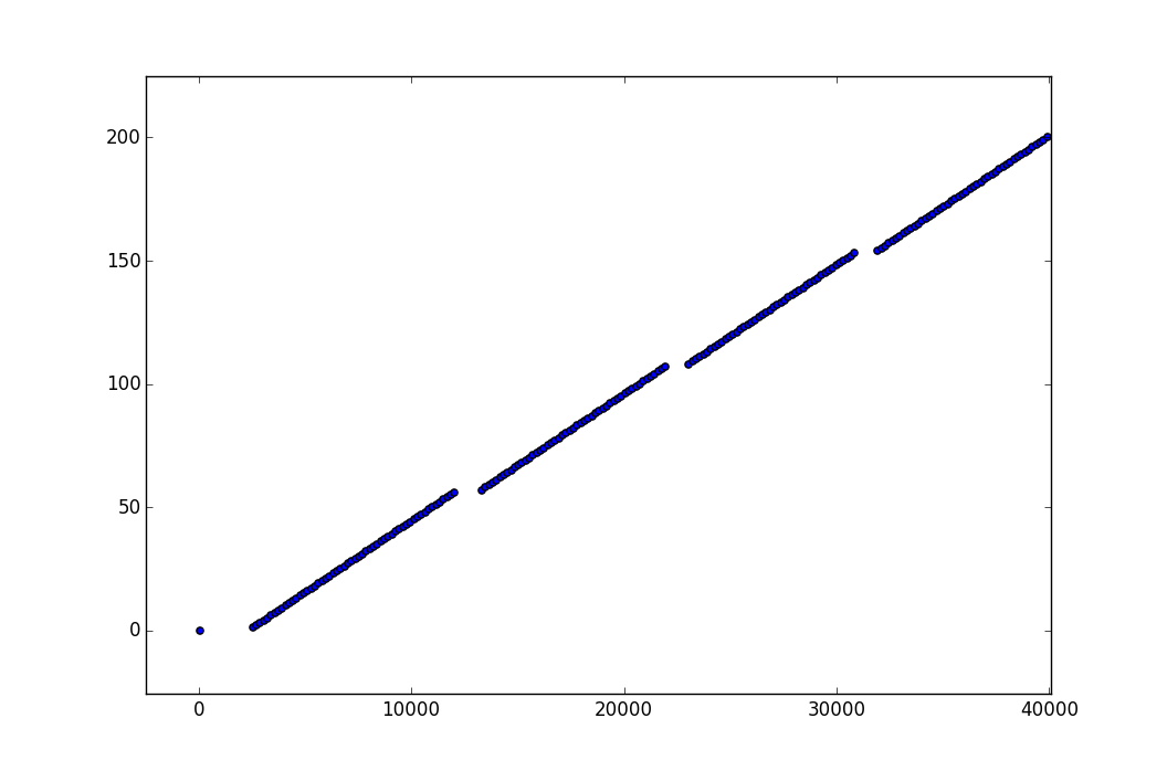

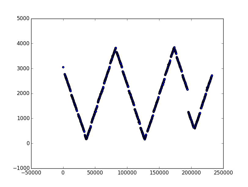

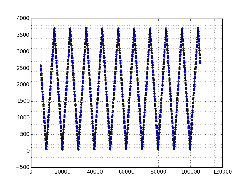

I'm trying to store data read from the ADC to a file on the SD-card. X1 is connected to an external function generator configured to a 10 Hz triangular wave.
As this plot shows there are some discontinuities in the data:
Data from ADC
I also tried storing the variable of the for-loop to check if the problem persists without the ADC (zoomed in view):
Data from loop variable
Both scatter plots use time from pyb.micros() for the x-axis.
Any info on what the pyboard is doing when it's not storing values? Would be good to know if there is a way to get better real-time preformance with this simple method. I guess it is better to use read_timed and store values to a buffer, and then only store to file when the buffer is filled, but probably need to understand the limitations to get that working properly as well...

Post by dhylands » Mon Mar 16, 2015 4:23 am
There is a timer tick interrupt which fires once per millisecond.
If you're connected via USB there is a periodic interrupt which is required to process USB stuff.
When writing to sdcard I believe that there is a periodic interrupt to ensure that buffers get flushed to the sdcard.

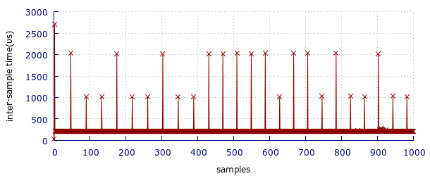

I think the jitter from 1ms timer interrupt is only 10 to 30 microseconds. not sure about the USB jitter, but it doesn't look like program is doing serial i/o. then there is the garbage-collection jitter ????
but running the code and looking at the data, i wonder if the periodic delays are from the SD fat interface actually writing a 512-byte sector (taking about 1ms or 2ms in some cases) as dhylands suggests. if memory allows, storing the values in an array, and then doing the SD write's might remove the big jitter.
In the plot above, most of the inter-sample times are about 207 us. There are no negative gap times, so time is always increasing.

Post by vikebo » Mon Mar 16, 2015 8:27 pm
Thank you for your replies.
As can be seen, there are two types of discontinuities. The short ones of ~1 ms are at ~8 ms intervals, and long ones of 10 - 12 ms with "random" intervals (sometimes several in a short time). I think the worst with these is that the timestamp counter for pyb.micros seems to freeze or run slower during the incidents, if it continued to run normally there should not be a vertical shift in the scatter plot since the x-axis is the timestamp. Also tried using elapsed_micros as well as elapsed_millis instead of subtracting starting time, both gave the same problems as before.
Regarding the serial port and USB, I used picocom during the tests, but I don't think I printed anything when the attached log files were stored. I tested again today without picocom connected, and the results were the same. Normally I use picocom to print debug info and do soft resets using CTRL-D.
I had some problems in the begining since I kept the SD-card on the pyboard mounted while logging, and the log files didn't show up on the computer. To avoid removing and inserting the SD-card all the time I edit the python file for the board in a local directory on the computer and run a short script called load.py to mount the SD-card while it is still in the pyboard, copy the latest file to the card and unmount it. Then I use the soft reset, and a similar python script to mount again, copy out the log file and plot the result using matplotlib.

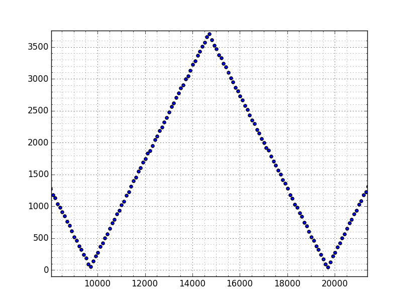

Also tried using timer callback to read the ADC today with better results. Inspired by one of Dave Hylands' examples, I made a class for timer 4.
I was able to achieve a sample rate slightly above 10 kHz, higher freq-settings for the timer gave just below 100 us between samples. As can be seen below things look much better, the frequency of the triangle wave has been increased from 10 Hz to 100 Hz. Having picocom connected during this test doesn't seem to affect the results. Of course storing to SD-card is done after all the sampling is done, so longer loggings may still give problems when data must be stored while new sampling is going on.
Haven't checked the priorities of timer interrupts for timer 3, which the documentation says is reserved for internal use, and timer 4 used in this test.
100 Hz input signal
Zoomed view of the same data

Post by vikebo » Mon Mar 23, 2015 10:01 pm

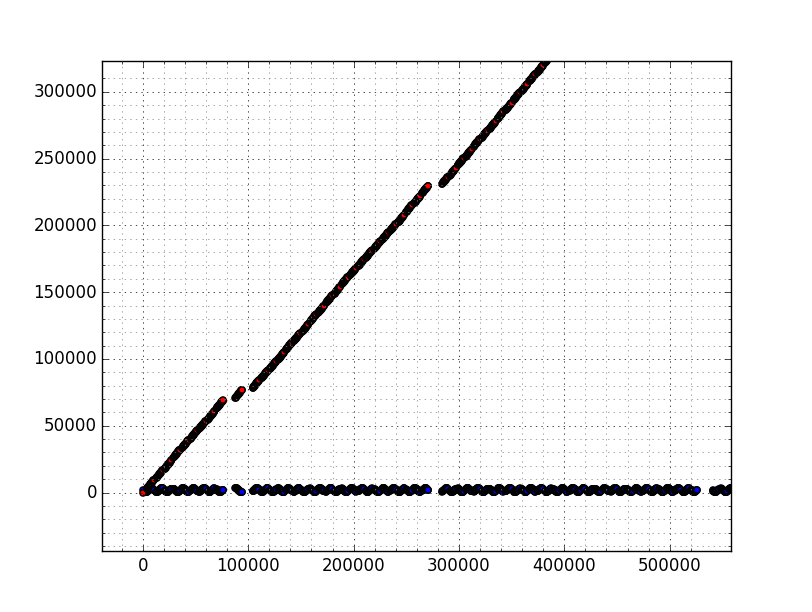

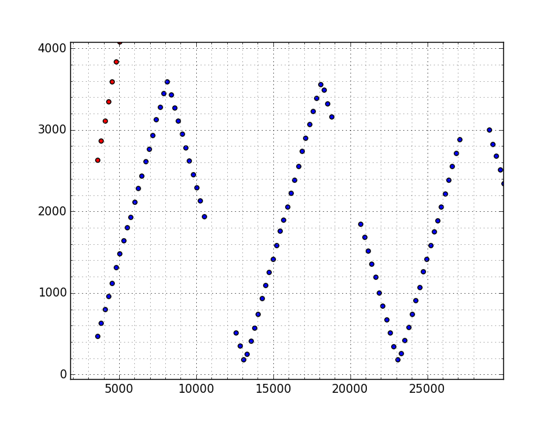

Manitou, didn't see your plot before today, it illustrates it very well. Probably a good idea to store data in a buffer first. I want to find the different options for sampling and storing data at a few kilosamples for some minutes, so data will have to be written while still measuring. Also looking into using bluetooth to send data out, but storing to the sd-card would be simpler and a stand-alone data logger have more uses.
Did another test using timer 2 as the timestamp instead of the micros function, but keeping the values from micros to compare them (red in the plots). Seems like the timer for micros does stop during the jitter, while timer 2 still runs. ADC measurements (blue) are missing during jitter, but the timestamp looks ok. At least for this kind of use this looks like a bug related to micros, but I don't know of all the uses for the function.

vikebo wrote: Did another test using timer 2 as the timestamp instead of the micros function, but keeping the values from micros to compare them (red in the plots). Seems like the timer for micros does stop during the jitter, while timer 2 still runs.
Wow, you are right about micros() losing interrupts. The SD driver disables IRQ's and I'm guessing that is the cause of both the pauses in the data collection and lost micros. Here are some data of the inter-sample gap times for timer2 (counting microseconds) and micros.
sample timer2   micros()
29       241     240
30       240     241
31       241     241
32       241     241
33       241     241
34       242     242
35    102721    1721
36       245     244
37       243     243
The "normal" inter-sample times are nearly identical, and the spikes (longer gaps) are synchronized, but often timer2 reveals that many milliseconds (102 ms in the example above) have elapsed in the SD driver :!:
Edit: writing to /flash files can also "stop" micros/millis due to flash-erase operation stalling the CPU (unless your code is in RAM)
