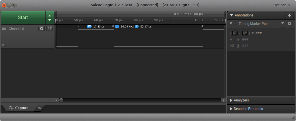

From the REPL I then did import pulser and this is what I captured on my C6 pin (aka Y1) using my logic analyzer:
which shows a high pulse of 17.83 usec, and low for 62.17 - 17.83 = 44.34 usec
