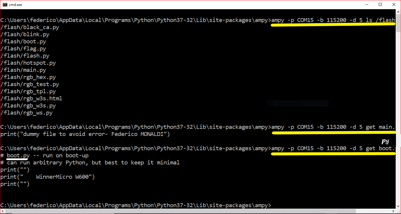

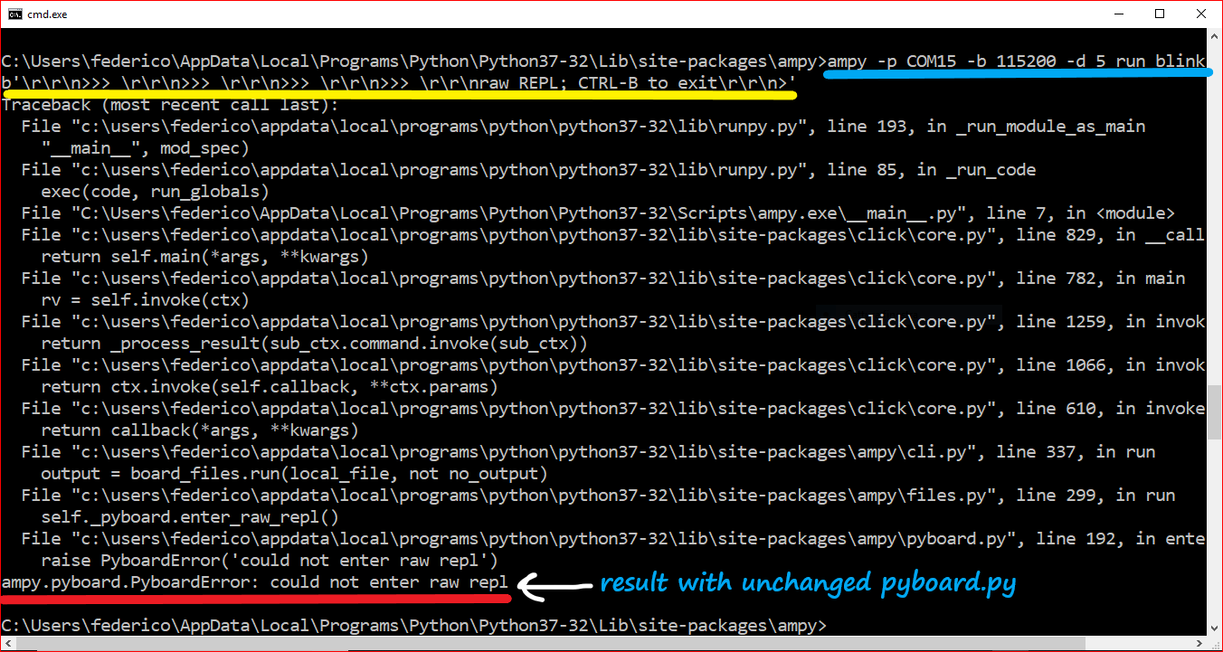

From the attachment 1,2,3,4,5 we have a practical demonstration about the results of interaction with an W600-PICO board, by an unchanged pyboard.py and an changed one.
The traceback says that the problem arise from the enter_raw_repl method defined in the class Pyboard ( line 192 of pyboard.py).
- get
- 4_ampy_w60x_get.PNG (52.06 KiB) Viewed 6493 times

- result with unchanged pyboard.py
- 1_ampy_w60x_pyboard_unchanged.PNG (95.68 KiB) Viewed 6493 times

I have upgraded my pyboard.py version with the last one on github ( doesn't require the ampy support) - I newly have changed the enter_raw_repl() in the Pyboard class and simulated your requirement as from the attachment - without any problem -
