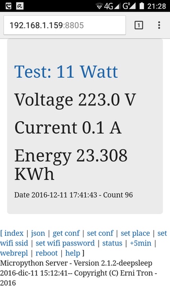

I solved it!
This is the ONE LINE solution.
One of the problem of my code was that 0x03 (the interrupt/control-c) was breaking the serial flow. It was not sufficient to trap the uart.read(), because the byte was missing from the serial line buffer. So the solution was simply to patch the uart.c routine in micropython to simply push it back into the serial line buffer. The Keyboard Event is still there and the try/except is simply to pass.

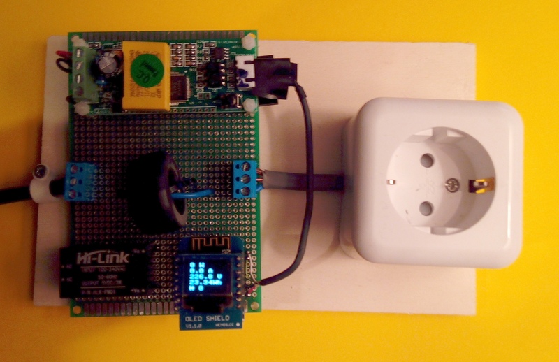

Now for those curious, this is the beast (yes, I am really proud of it!). It features:
- Power meter by means of the notorius PZEM004t (a hell of a chinese power meter)
- WeMos D1 Mini
- SSD1306 OLED Shield
- Independent Power Supply
- My own web server and code. Also it saves data on my personal IoT cloud server for nice graphics...
- A lot of work and swear and pain and joy... well you know
Now few things:
- WeMos but also Lolin V3 are pretty robust when it comes to voltages. PZEM004 works with TTL levels and WeMos/Lolin work with 3.3. I did NOT use any ttl converter. Even the resistor suggested somewhere (https://wifi-iot.com/?m=wiki&id=15) was more harmful than useful.
- You might say that I am very close to fry my chip but I am positive they won't
- I haven't seen any other binary data messing up with uart repl. I made a lot of trials disabling debug, sending Control-A to go in raw mode, but nothing was necessary.
- I didn't even connect to ground anything (). SO I guess there are some floating voltage around. But I think I will try to ground the circuits.
- I think the key to stability is the independent power supply.
. I didn't get the KWh but just followed the instructions from chinglish.
After all I think this works with some magic. For those interested I think I will put all on github... and no, I will not publish anything on instructables or hackster.. or anything. Just bewteen the few of this community and me...
