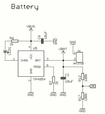

Has anyone had problems with the LiPo connection on D32Pro? I have been running along fine with USB serial power.
I get a decent reading at the battery terminals on the board, but nothing further in. Even VBAT has nothing ?!? I have a Lolin32 Pro V1.0.0 (with apparently the same battery circuit) which runs fine off a LiPo.
I can't find any known problems on the ESP32/wemos forums. Has anyone else experienced this problem?
