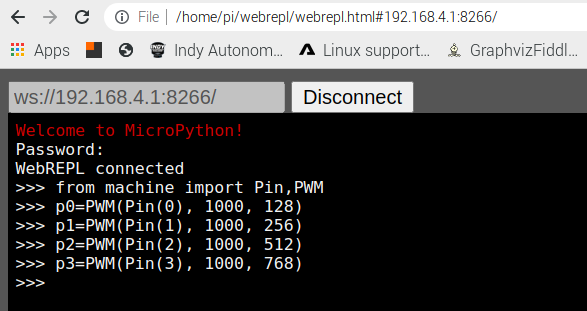

I can control motor driver below the lipo fully after I hexediting stock MicroPython image for enabling PWM on all 4 IO pins:
viewtopic.php?f=16&t=11466
