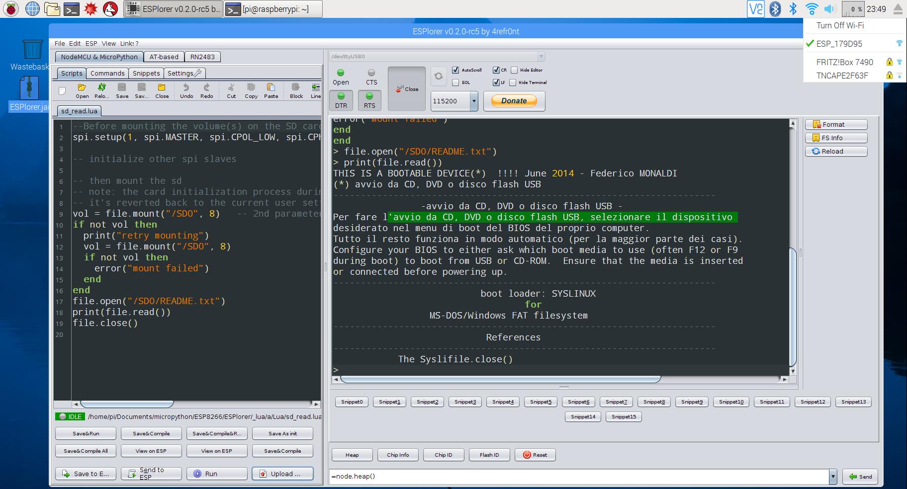

Object : microSD card reading on FeatherHuzzah and Huzzah ESP8266 boards
with installed micropython firmware.
** for more details about the used firmware see the following upython REPL session report.
As microSD card adapter a Adafruit Micro-SD breakout board is used.
The same SD adapter has been used with a NodeMCU dev board with
a Lua firmware installed. As we can see from the jpeg attachment, from
the ESPlorer session, the SD card reading has been positive. This result
demonstrate that we are working with good SD card adapter e that with Lua
we do not have problems.
I suppose - if I do not have done some wiring error that you can verify from the
attached pictures or from the wiring description - that the problem could be
or in the sdcard.py driver or in the firmware that I have installed on the two
Adafruit ESP boards.

- NodeMCU Lua firmware
- sd_mount_succes.jpg (248.41 KiB) Viewed 40948 times
