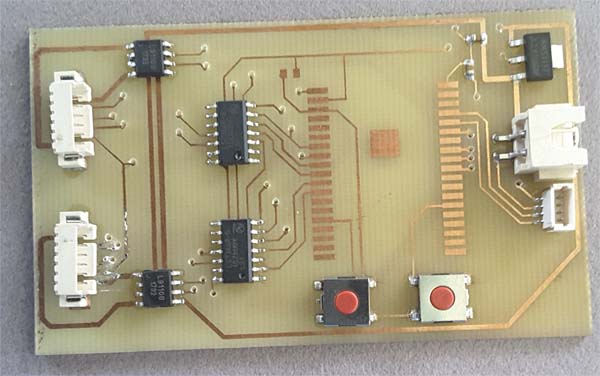

I have also started to laser etch PCBs and have now made my own Wrover breakout with the needed H-bridge chips and encoder counters with SMD connectors for my other robot that I am developing Image
