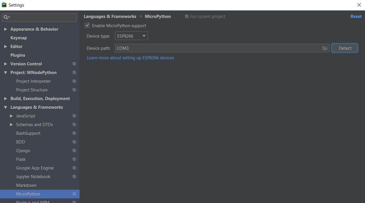

It does still work, you might just need to set the device and path correctly (obviously adapt to pyboard):

Syntax is because of missing pyb module. Should be fixed if you set your device to pyboard (see my image).

Yes like that. Should typically work but I don't have a pyboard to test. With my esp8266 it works and adds an external library:
Maybe try to disable the micropython support for the project so that these get remove and activate it again or restart pycharm.
