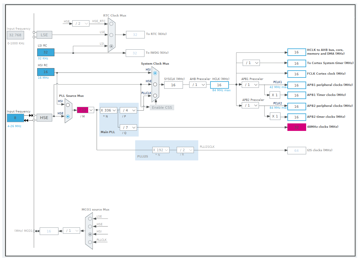

You can output any of the clocks to the MCO pins see attached pic of the setup for the STM32F4 then read them with a scope :)

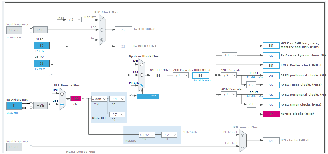

Here's a screenshot of your config:
The error info for the /M node is "PLLM output frequency is currently set to 0.666666 MHz. Must be >0.95 MHz and < 2.1 MHz"
The tool suggests (for 8MHz HSE and 48MHz USB):
/M  4
*N  72
/P  4
/Q   3

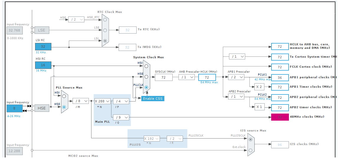

Nice tool, I updated the config to have the good APBx prescaler and SYSCLK:
Same "warning" but that' s so weird as the board works and the USB too with those settings.
to fix it, nn my case it proposes:
M:4, N:72, P:2, Q:3 => USB:48, SYSCLK=72
I tried this fix and other settings which set the USB to 48MHz as it should be but doesn't work.

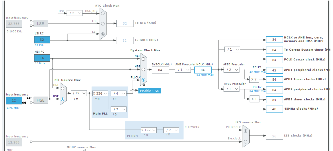

The only settings I found working (with the USB) are:
M: 12, N: 336, P:4, Q:7
M: 8, N: 288, P:4, Q:9
see below, same USB freq: 32MHz...
So I thought the HSE was wrong (with HSE=12MHz, it would generate a 48MHz USB and set all max values!)
That's why I ran those performance tests but it seems HSE is really 8 MHz..
