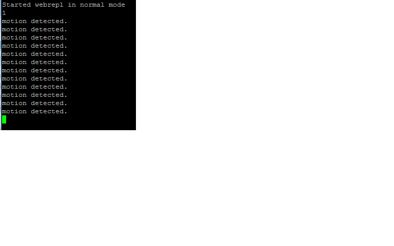

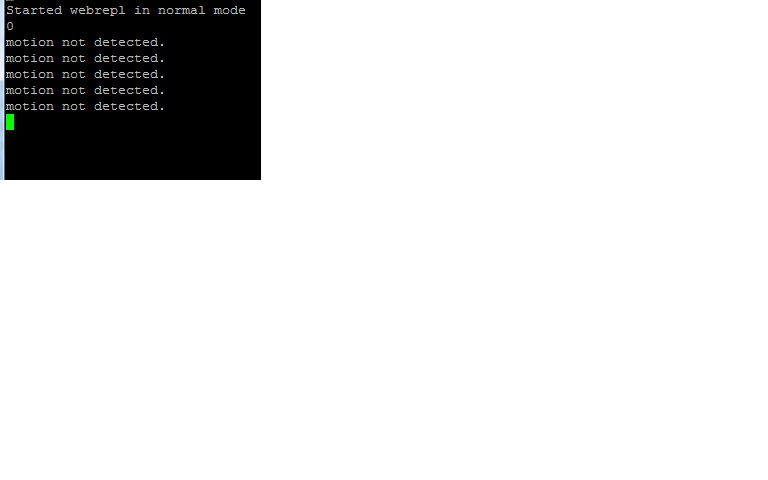

i m trying with PIR sensor and below is the code in main.py, when i run the code on esp8266 board i am getting as below screens and each time i need to reset the button to detect the motion. can someone suggest me where i do wrong.
main.py
pin=Pin(2,Pin.OUT)
pir=Pin(14,Pin.IN,Pin.PULL_UP)
a=pir.value()
print(a)
time.sleep(3)
if a==0:
print('motion not detected.')
if a==1:
print('motion detected.')
pin.off()
time.sleep(2)
pin.on()

You have to put "a=pir.value()" inside the while loop.
It has to ask the pin in every loop
Thank you it's working as expected.
