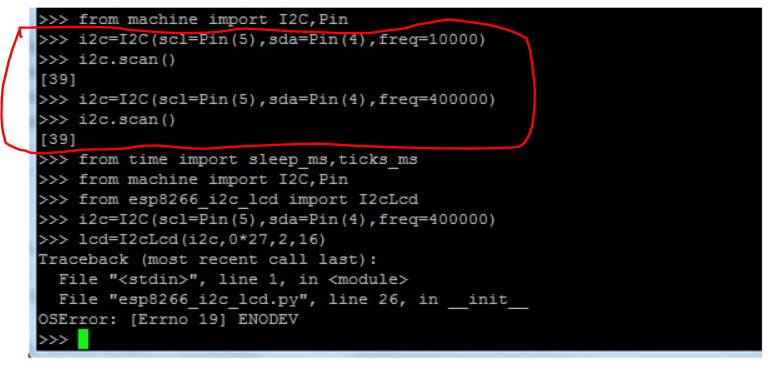

Sun Jun 09, 2019 6:03 pm
What do you get with
from machine import I2C
i2c = I2C(scl=Pin(5), sda=Pin(4), freq=400000)
print(i2c.scan())
Hi Robert, i got [39] as per below screenshot
Re: LCD 1602 - Library
Post by Roberthh » Mon Jun 10, 2019 5:53 am
The instantiation of lcd should be:
lcd=I2cLcd(i2c, 0x27, 2, 16)
or
lcd=I2cLcd(i2c, 39, 2, 16)
You screen dump shows 0*27, which is 0

Post by RajaRamesh » Mon Jun 10, 2019 5:43 pm
RajaRamesh wrote:
Mon Jun 10, 2019 11:46 am
Thank you Robert. i will check and get back to you.
hi robert... now i can see text on lcd after updating with 39. is it possible to scroll the text on lcd from right to left or left to right?
