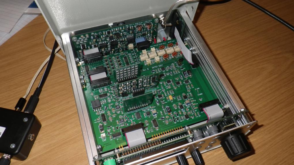

My definition: "Hobby: An activity I like to do that consumes a lot of time an/or money and is allowed to temporarily/permanently occupy space, normally designated for other purposes (e.g. having a soldering station in the kitchen)."
I actually had a soldering station in the kitchen for several months when I assembled this:
It is a Yuma TRX2A short wave radio. The PCBs were delivered empty and all the SMD components had to be soldered on. Even the coils had to be wound by hand. Basically a 2000 pcs puzzle you have to solder together. The thing works an I am able to make contact with Europe from across the Atlantic on 10W transmitter power (using morse code on 10 or 20m band). My antenna isn't the best (not enough ground radials), so I yet have to succeed with real QRP on 5W.
