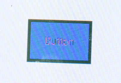

Mike Teachman wrote:
Sat May 16, 2020 12:20 am
I faced the same problem and found a workaround by modifying the C based ILI9341 display driver,
I build with your modILI9341.c file.
SDcard and LVGL work, but button colors are rainbow striped.

Have you encountered this?
The Pure/Hybrid driver works fine except for SPI issue
2020-05-20 12_50_14-DSC_1373.JPG - Windows Photo Viewer.png (132.53 KiB) Viewed 7748 times

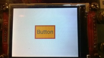

Post by Mike Teachman » Wed May 20, 2020 9:01 pm
I tried out your posted code and unfortunately I don't see the striped button.
Capture (Phone) (Custom).PNG (147.28 KiB) Viewed 7737 times
One suggestion is to try setting the background color of the button to see if it changes. Here is a screenshot from my display and the code I added to your example to set the background color and a border.
WP_20200520_007 (Custom).jpg (58.9 KiB) Viewed 7737 times

PM-TPI
Posts: 75
Joined: Fri Jun 28, 2019 3:09 pm
Re: LVGL and SD Card won't share SPI bus
Post by PM-TPI » Wed May 20, 2020 9:27 pm
still bad colors...
