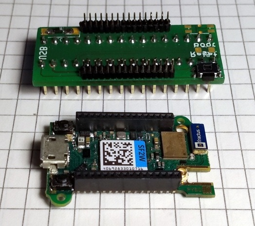

I'm just wondering how on earth people are actually physically handling the i/o for this teeny device. It's so beautifully designed and made, that it seems a great sin to be soldering anything directly to it. Would love to hear from anyone how they've gone about actually connecting things to it for prototyping/general tinkering (rather than custom DIP interface pcb, for example) & any links/pics would be greatly appreciated.

I use the WBUS-DIP28. There is also a DIP68 but this is rather large for some projects. There was discussion on the notion of a DIP32 adaptor which simply brought out the pins on the D series edges to a breadboard friendly format, but my requests for updates on this have drawn a blank so I don't think this is going ahead.
I have considered DIY but the mechanical alignment for the WBUS connectors troubles me.
For projects powered by USB and/or LiPo the DIP28 works well. But it only brings out a subset of the Pyboard edge pins, it doesn't readily support use with a custom PCB with 5V power, and for many applications the power control circuitry is redundant. Hence the DIP32 idea.

I used the DIP28 and a custom DIP interface PCB when I need the pins not available at the DIP28. The DIP68 is way too large. A simple DIP32 which brings out all edge connectors would be fine.

No, it does not use the D Bus connectors. That is too hard for me to make, with the tight requirement for tolerances. My board just stick to 1/20" female pins soldered to the top of the PyBoard D. I had sent you an item of that board. Not beautiful, but it works.

Post by Roberthh » Mon Nov 02, 2020 4:09 pm
Attached are two pictures. The Kicad files are here: https://github.com/robert-hh/PYBD-Adapter

Ah! That's exactly what I'm after. Thanks for posting the kicad files too

That is excellent.
I didn't know you could get headers with 1.27mm pitch. Are these widely available?
