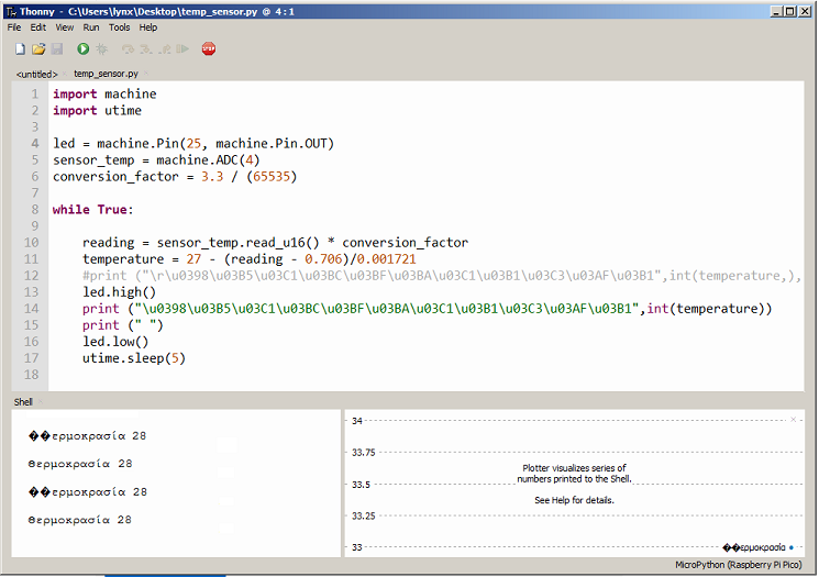

Hi
seems that i discovered something that looks like a bug in MicroPython (v1.16.uf2), there's a random corruption
shown in the text printed to the terminal when using UTF-8
Since i'm too new with arm microcontrollers and Micropython i can't do much research on how and why
this happens but i've noticed the corrupted text only appear in the terminal and not if you try to save it
in a file where it appears normal.
there was a discussion going on on another forum and a member could confirm the issue too
by running the same code i'm posting bellow, he is also member here so he can jump into
this thread if he wants to say more about it.

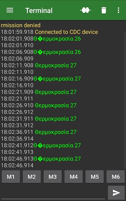

yes it should say "Θερμοκρασία", although as you can see in the photos random characters
pop up in some of the lines and i don't think it's the same case as the one you describe.
sorry that i posted all of my code but i guess it is preferable to have a clear picture of
what i was doing and i've noticed that text corruption.

Post by Citylights » Sun Jul 11, 2021 3:06 pm
i already did, the one is on android phone and the other it's Thonny IDE on a PC.
and if you notice the problem is not on every line of text.
you can pick up that part of my code which prints the text and put it in a loop
so you can see if it happens also on the terminal you use.
