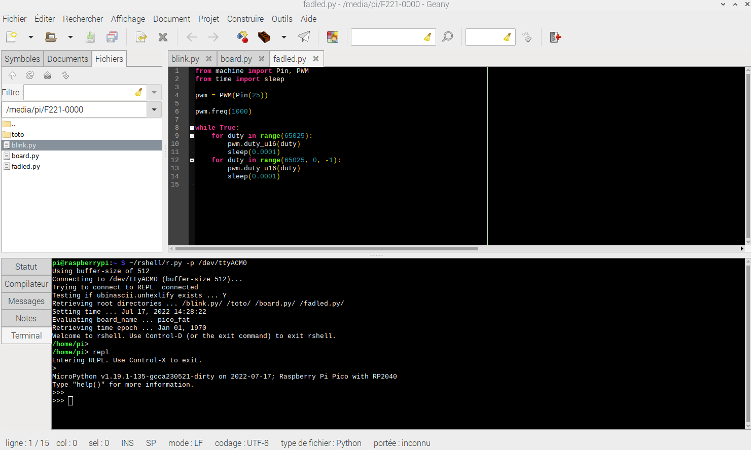

With this mass storage (FAT or littleFS) I'm able to configure my favourite editor: geany with 3 windows:
- the mounted file system
- the edit window
- a terminal window where I run rshell
I get a "Thonny" like app where I can edit and run code on the pico. Awesome!
Here under is a screenshot
As you said:
Yes, changes are not always visible in the MicroPython REPL when done on the PC. I have to exit and open again the REPL to see the changes.But be careful. The PC is the master, and changes made by the PC are not always visible at the board. And do not write at the board while it is mounted. There is no protection against trouble.
I did not try to write to the filesystem from the REPL while mounted on the PC, I usely don't need, I take note of being careful.
I must try now:
Doing the same for the PICO_W (should be easy only the block_count will change I think)
Doing the same for ESP8266 and ESP32 (I already check and it seems different)
Thanks again
- ScreenshotGeanyPicoFatRshell.png (140.67 KiB) Viewed 17813 times
