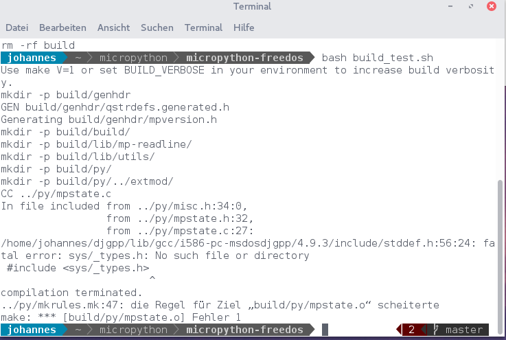

Followed the instructions so far. DJGPP builds without errors.
Getting an error while building the Freedos port:
/home/johannes/djgpp/lib/gcc/i586-pc-msdosdjgpp/4.9.3/include/stddef.h:56:24: fatal error: sys/_types.h: No such file or directory
#include <sys/_types.h>
compilation terminated.
Used this env setting:
export CROSS_COMPILE=/home/johannes/djgpp/i586-pc-msdosdjgpp/bin/
export DJGPP_GCC=/home/johannes/djgpp/bin/i586-pc-msdosdjgpp-gcc
make
screenshot:
