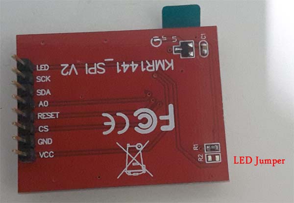

Post by OutoftheBOTS_ » Thu Feb 22, 2018 11:17 am
I have had a bit of a play with the 1.8" ST7735 display.
There is a 0 resistor as a jumper to set if the LED is permit shorted to the 3.3v trace so this means that I can power the screen from the LED pin and not use the Vcc pin to cut out the LDO regulator. see pic
I couldn't get to to work on the ESP32 using the display module in your firmware even when trying lots of different options as you suggested. So I though that I better rule out the screen not working so I hooked it up to the RPi and googled for a driver and found this 1 and after fixing a couple of typos it worked https://github.com/jackw01/raspi-python-st7735
Making this screen work isn't a high priority but I would like to get it to work with the ESP32 at some point because it will be great to display if the ESP32 was successful of wifi login and display the IP as well as the battery status and another use info about the robot.
