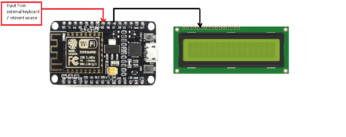

Hi pythoncoder, below screenshot may give an idea what i am trying to say. is it possible to pass a value from external device at runtime to ESP8266 ?
Re: How to switch on a electric bulb with ESP8266 board?
Post by pythoncoder » Mon Jun 17, 2019 5:51 pm
There are many ways to do it, depending on the electronic interface of the device. MicroPython supports various interfaces: UARTs, I2C, SPI, CAN or simply changing Pin inputs. There are also drivers for various devices, some official, some contributed by users. UARTs are somewhat problematic on ESP8266 because the hardware only has one proper UART: this is used for the REPL.

Post by RajaRamesh » Tue Jun 18, 2019 9:11 am
So, could you please share the electronic device names or share the links where i can get an idea. so that i will try to send values to ESP8266 and then display the output on LCD screen.
Post by pythoncoder » Tue Jun 18, 2019 9:49 am
The Wiki http://wiki.micropython.org/Home has links to drivers for a variety of devices. You can also search this forum.
